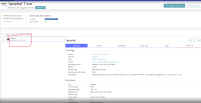

Hi team,
I'm using Java, Netflix DGS, and WebFlux. I want to see what kind of query being made to /graphql (operation name in /graphql endpoint)
But on my test, it wasn’t shown. Could you guys help me?
Many thanks!

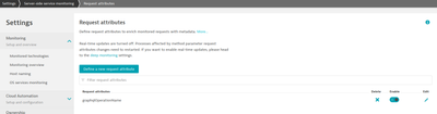

Our team has included operation name in the logs with following steps:
1. define global request attribute
2. inject custom attribute with one agent sdk
@Component
@RequiredArgsConstructor
public class DynatraceGraphQlInstrumentation extends SimplePerformantInstrumentation {
    private final OneAgentSDK oneAgentSDK;
    @Override
    public @NotNull ExecutionContext instrumentExecutionContext(
            ExecutionContext executionContext,
            InstrumentationExecutionParameters parameters,
            InstrumentationState state) {
        oneAgentSDK.addCustomRequestAttribute("graphqlOperationName", executionContext.getOperationDefinition().getName());
        return super.instrumentExecutionContext(executionContext, parameters, state);
3. define global request naming rule with the API. This makes operation name became visible in the request name. Docs https://docs.dynatrace.com/docs/dynatrace-api/configuration-api/service-api/request-naming-api.
Final result:
