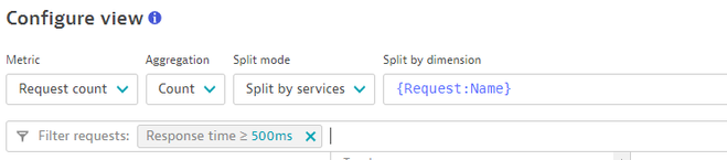

I'm not sure if this is possible within the standard dashboarding. What you can do is create a multidimensional analysis to check it. So firstly use the query above to get the value, then use the Multidimensional Analysis to get the number of calls.
This will give you the number.

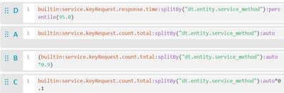

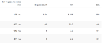

To add on Julius:  you can combine your data explorer query with metric:
(builtin:service.keyRequest.count.total:splitBy("dt.entity.service_method")*0.9) for for fast request count
(builtin:service.keyRequest.count.total:splitBy("dt.entity.service_method")*0.1) for slowest 10%
Tried playing around with percentile in metric above but does not seem to give the right number.
@Julius_Loman what's your experience with this?

Metric precision will never match the MDA since with metrics you work with 1-minute resolution aggregates at minimum. With MDA it's per request, and it will provide the most accurate answer.
