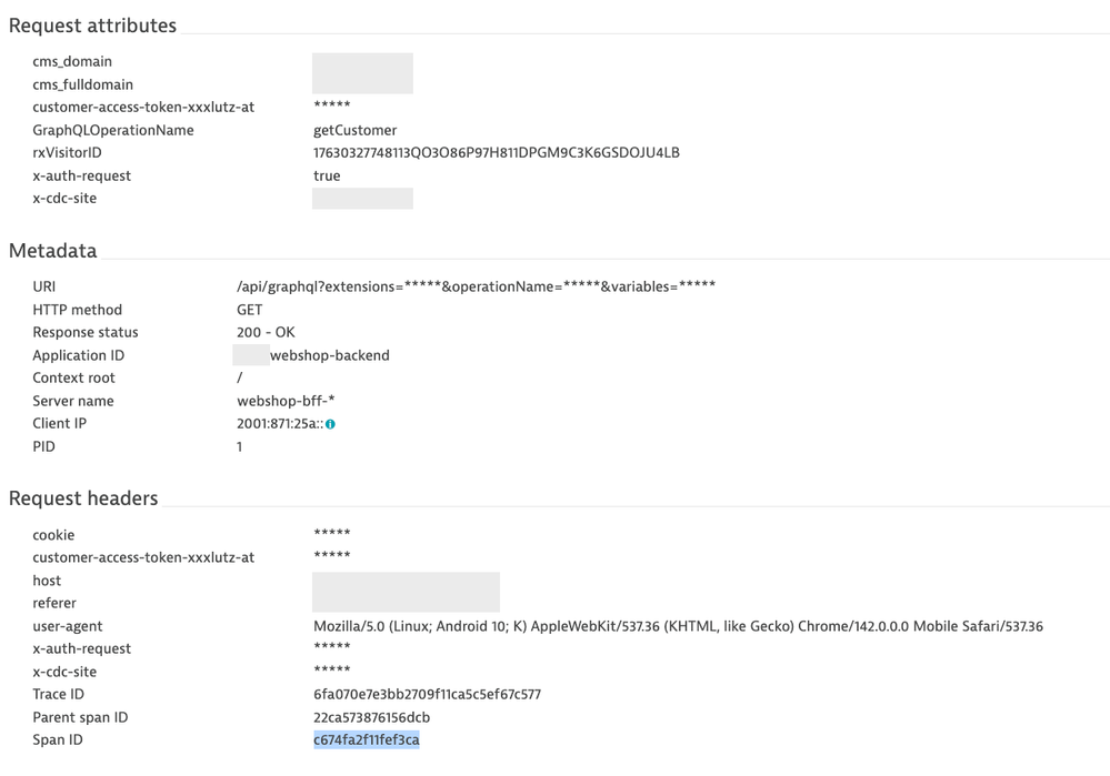

I was not able to reproduce it. For me , the HTTP header is always masked with asterisks for users who do not have the view senstivie data permission.
Here is what I'm seeing (the user doesn't have permissions to view sensitive data "classic" and no special policy to view sensitive data in grail):
In the classic view this seems fine:
Headers are masked, and RA that have "access to masked data" but are themselves not sensitive are shown (allows to extract parts of the sensitive header):

Solution(?):
So what one has to do is to define a custom fieldset for the http header (that the RA is based on) to prevent access to it:
  "name": "sensitive-fields-idp",
  "description": "Sensitive field for IDP",
  "enabled": true,
  "scope": "TABLE",
  "fields": [
    "http.request.header.customer-access-token"
  "tables": [
    "spans"
and then potentially also allow this in a policy.
