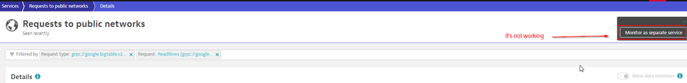

When I try to separate a gRPC call from the requests detected as "Requests to public network" it's not working. The support suggested to use the Service Detection Rules, but I tried a couple of different rules and didn't work either.
Does anyone know how to accomplish that?

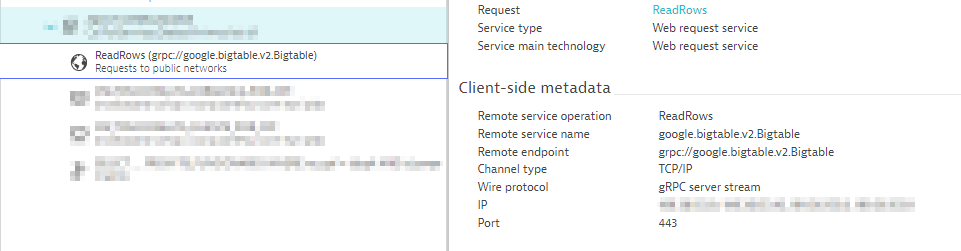

The trace information looks like this:

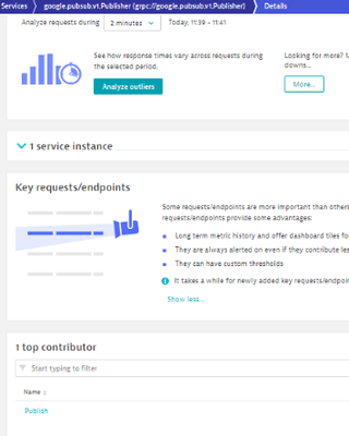

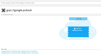

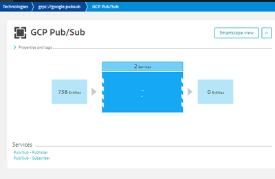

Same case here with over Dynatrace SaaS:
grpc://google.pubsub.v1.Subscriber
and
grpc://google.pubsub.v1.Publisher
Could you help us?
Thanks in advance
