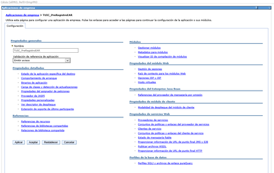

My customer has defined alot of business applications under WAS (IBM websphere Applications Server). The problem is that Dynatrace does not detect that application name in any metadata with which to rename the services.
I had thought about capturing that field and using it in the renaming, but I don't know if it's possible either
If anyone has any ideas, they are welcome!
