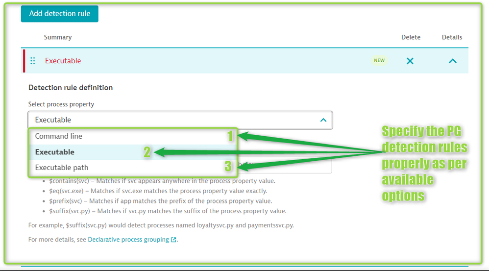

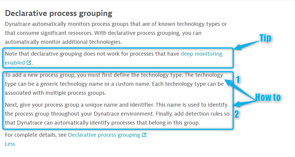

@kherring  in your case (non-deep monitored processes) you need to use Declarative Process Grouping.

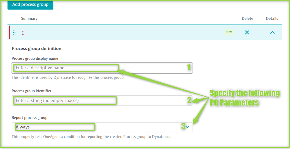

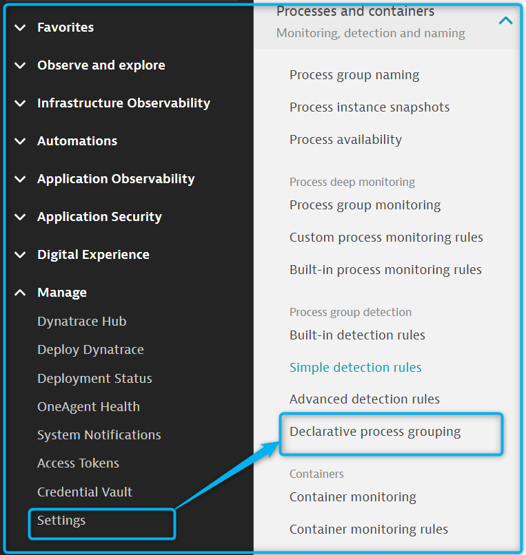

Hello @kherring
As advised by @Julius_Loman
You can create declarative process grouping through the attached steps via the UI.
Manage > Settings > Processes and containers > Declarative process grouping.
After configuring detection rules, create the required tagging rules that reflect the PG setup.
