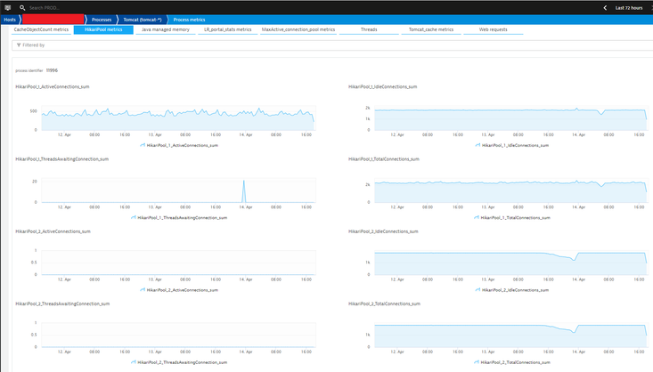

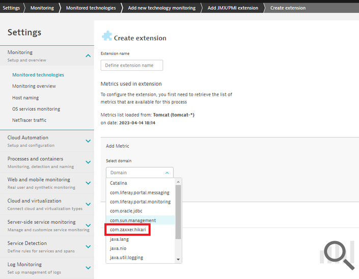

Maybe you should try to collect them via jmx. For hikari it should work.
Available hikari metrics in this system:
ActiveConnections
ConnectionTimeout
IdleConnections
IdleTimeout
LeakDetectionThreshold
MaximumPoolSize
MaxLifetime
MinimumIdle
ThreadsAwaitingConnection
TotalConnections
ValidationTimeout
I hope it helps.

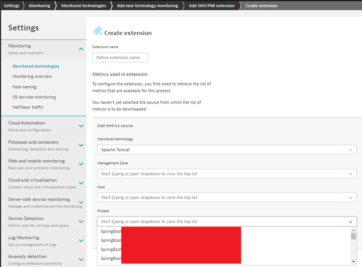

Collecting the metrics using JMX has two caveats:
  • MBeans might not be exposed depending on the configuration
  • You need to create an JMX extension for that and always adapt it to application changes. This is a cat and mouse problem.
