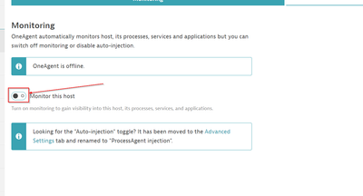

Hello dear community, I turn to your infinite wisdom for guidance. I have some Kubernetes clusters in a QA environment that are turned off every night and turned on the next day. I have Dynatrace installed on these clusters, but I generally use it on-demand. The problem occurs every morning when the clusters are turned on, they come up with a new name and this causes the configuration I left the day before (turning off One-agent monitoring) to be lost and One-agent to start in ON mode.
Is it possible or is there any configuration in the One-agent installation that starts in OFF monitoring mode?

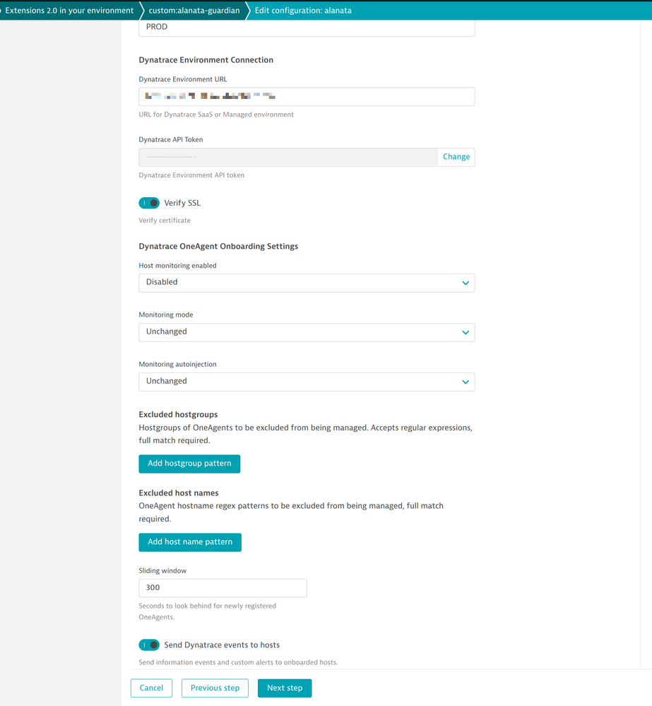

We have developed an extension 2.0 which allows you to define profiles and sets one agent modes accordingly to the profile for new connected OneAgents. If you are interested, reach out to me here in the thread.

@Ellery our extension allows you to configure newly connected OneAgents and disable them or switch the monitoring mode according to the defined rules, I think the screenshot says it all.
