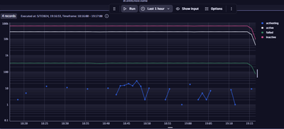

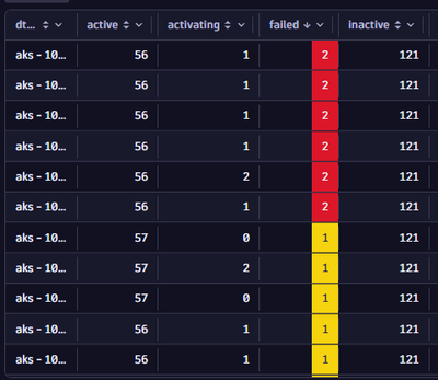

06 Jul 2024 01:19 AM
Now understand, i was thinking in services in general, after your message try to doit by myselft and notice that its right, there is not a way to doit without reach some limits.
- set a tag with the host name for every service in the host ( no posible if there ist more than a x quantity)
- set a tag by group or range of ip (no a viable option because its not an easy way to drill down in problem)
- set the tag by hostgroup (probably a good option but not too far from a nightmare to drilldown)
and etc..
i was thinking now for the use of this the host in the service inside a host. maybe you will need it when a problem its raise and need more information in the message.
but while i was thinking in that got this for me.
timeseries availability = sum(dt.osservice.availability), by: { dt.entity.host, dt.osservice.status, `dt.entity.os:service` }
| fieldsAdd entityName(dt.entity.host), entityName(`dt.entity.os:service`)
| summarize count = count(), by:{dt.entity.host.name, dt.osservice.status, entityName(`dt.entity.os:service`) }
| summarize active = countIf( dt.osservice.status == "active")
, activating = countIf( dt.osservice.status == "activating")
, failed = countIf( dt.osservice.status == "failed")
, inactive = countIf( dt.osservice.status == "inactive")
, by:{ dt.entity.host.name }
or
i was not able to set the host for the os:services but get something to analyze .. thank you
