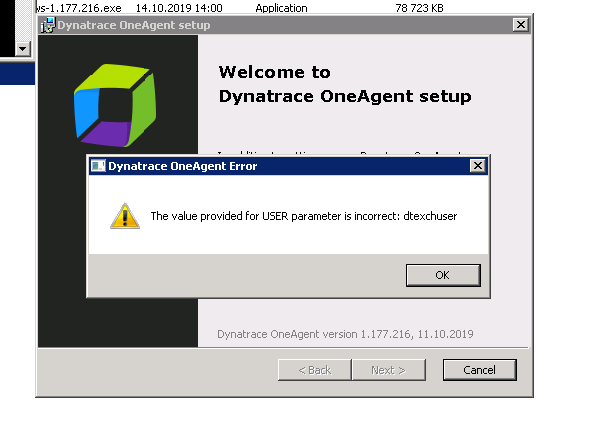

I tried to install OneAgent on Windows host with User parameter.
I added parameter to bat file and start installation but have error - the value provided for USER parameter is incorrect
Could someone please tell what is the problem?

According to documentation you cannot pass this argument the way you've done it. Availabile options ar no_create od dtuser. This settings is only supported for msi command-line installer. So you have to convert your exe to msi.

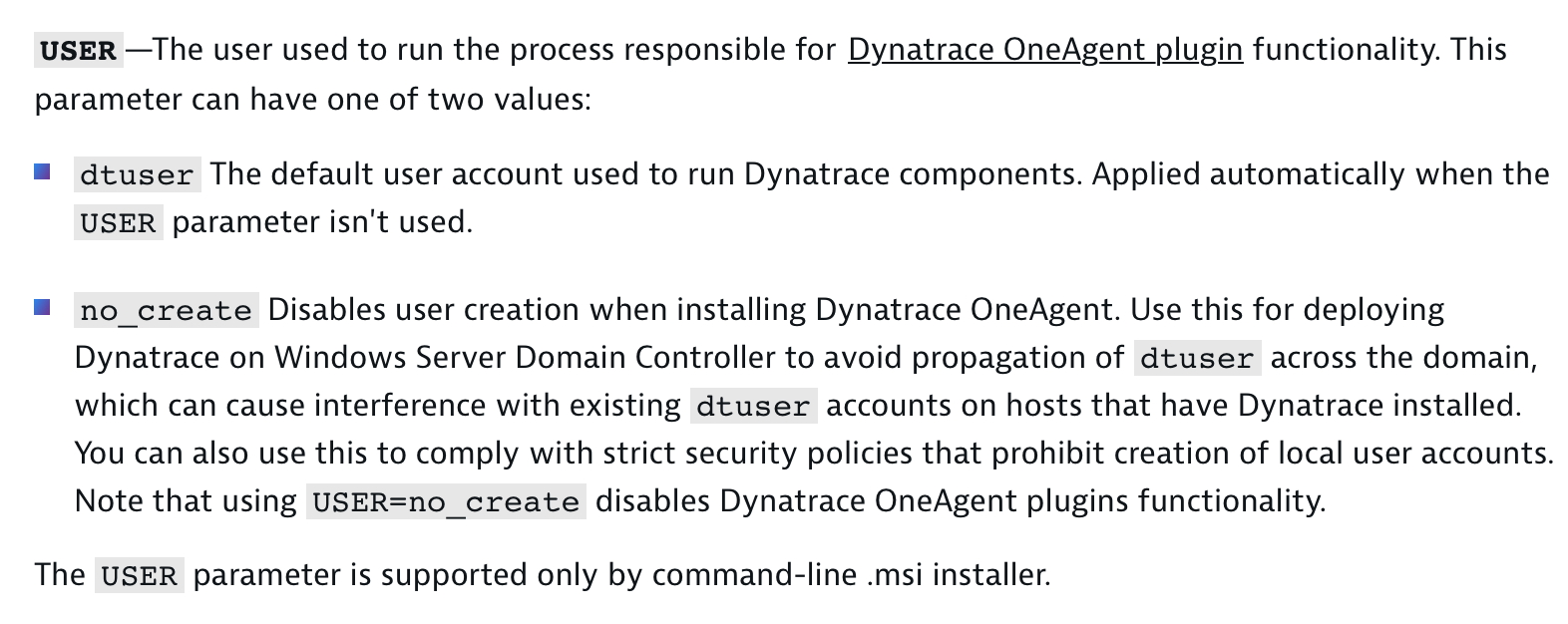

In doc is written
  • Note that using USER=no_createdisables Dynatrace OneAgent plugins functionality.
Ok sorry, my bad, you can pass your own username using user parameter, but you have to do it on MSI installer, not exe one. As I see here on screenshot you ware using GUI to install agent, you should use commandline (according to doc).

But In doc is written
but I need the plugin to work
On screen there is no silent installation I see installer. You have to create msi from exe and use commandline then. And as I said, you have to pass user here different than default because as you said, no_create will disable plugins.
The user cannot be customized, you can choose to either:
  • Use default user: dtuser
  • Do not create the user, what means that Plugins will be disabled
Ok, Thank you @Tomasz G.
Сould you please tell me, in other words, I cannot use the OneAgent plugin to collect metrics from Active Direcroty since dtuser will propagation of across the domain, which can cause interference with existing dtuser accounts on hosts that have Dynatrace installed?
Yes, that is correct.
