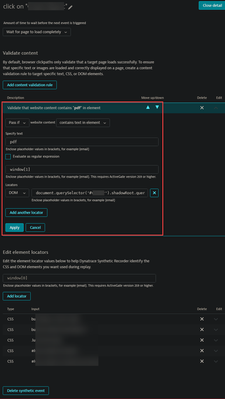

For one of my Browser click-path monitor I want to validate if pdf generated successfully or not for last step.
When we click on generate a report and pdf generated in new tab. I'm trying to utilize the "Validate content" feature however, it keeps failing.

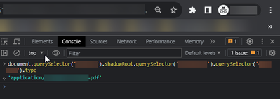

I'm using adding shadow DOM as DOM locater like below,
I have validated against developer console and it is giving me appropriate element that I'm looking for.

From 'Element' section of dev console shows me that the required element is under shadow DOM and I'm able to successfully access it via below query and the same I added under validation.
Result in dev console for the same query. (I'm not using type attribute in monitor so that it will return whole element)

Usually Shadow DOM is used instead of frames but it could still be possible to have both. If you right click on the page where you want to validate, then you would see both view page source and view frame source by the Inspect option, if it's in a frame. If it is, you will need to add the correct frame to the window field.
I validated this by myself and with chat support as well.
As per their response, the recorder doesn't currently support shadow DOM. Shadow DOMs are completely isolated, so the agent has no access to them. A Shadow DOM doesn't have its own JavaScript runtime and is not accessible from outside.
I have added another DOM (not a shadow DOM) which is working perfectly fine for validation.
