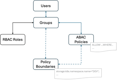

regarding the first approach how we make the pulled data regarding specific group or app
You need to properly implement ABAC, https://docs.dynatrace.com/docs/shortlink/migrate-roles#abac-implementation-in-your-dynatrace
And create access from Customer 1 users in Customer 2 tenant.
