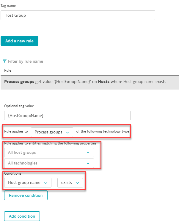

Yes you can! I recommend doing it from the UI then pulling the Json of that rule. If I understand your question correctly, you would like to capture the Host Group, Dynamically, and set it as a tag, but only for entities assigned to a specific host group.
You will need to do the following:
Create a new Auto Tag rule and name it Host Group. Then add a rule for the host, process, or service, or all of them. and in the tag value you will put {HostGroup:Name}. This will grab the Host Group Value for the entity and put it into a tag. Then select what the rule applies to, and then isolate (if needed) the Host Group and such, and then set conditions. This will allow you to Narrow down the scope even more for the rule. If the Host Group Name Starts with or contains Easy Travel.
Click Preview and ensure that your desired entity shows up and then create and save the rule. then you're done. Then you can pull the rule via the API and use it as a template.
