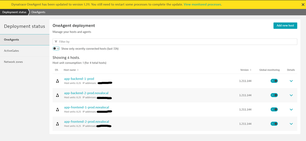

Hello,
on our Dynatrace instance this message is appearing:
What does it mean, exactly? That the OneAgent process should be restarted?
Thanks

Hello,
That's telling you that you'll need to restart some of the processes that the OneAgent is monitoring. Monitoring of the processes shouldn't be impacted, but for the processes to pick up the new version of the OneAgent a restart is needed.
Hope that helps,
JH

Hi, I show you a detailed example

Hello,
I think the backend processes have been restarted, but Dynatrace is still showing the attached message. What do we have to do?
Thanks

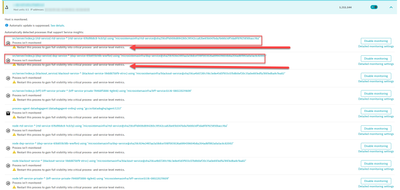

12 Apr 2021 07:24 PM
If you already restarted the processes only click on the "x" on the yellow box.
Because if you click on the pull down "v" you can see the detail of the processes pending to be restarted. (see the example below)
