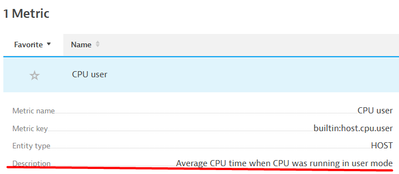

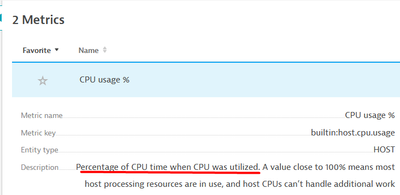

Regarding the description of each metric, you can get an idea by checking the metrics tab:
For example, for CPU user vs CPU usage %, here's the difference:

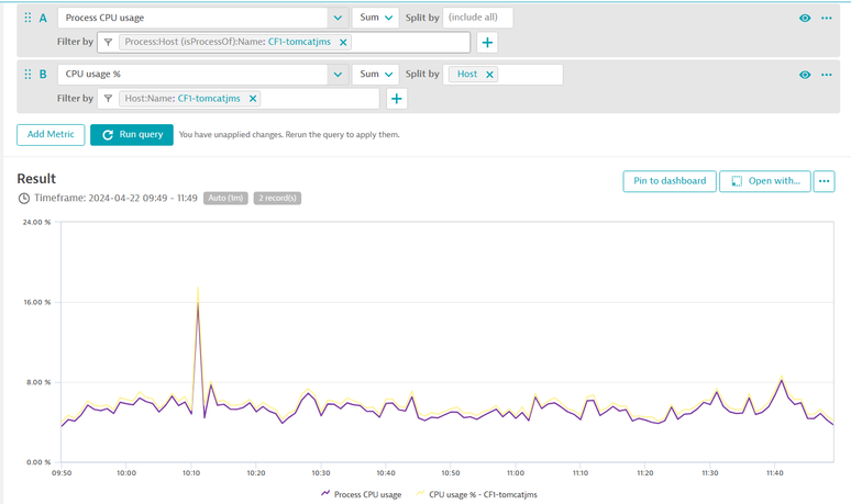

The one you're looking for should be builtin:host.cpu.usage. And for the comparison between that and the builtin:tech.generic.cpu.usage per process, they should be around the same when aggregated. From my tests:
Can you provide the metric selectors of yours? It may be helpful to see what's going on there.

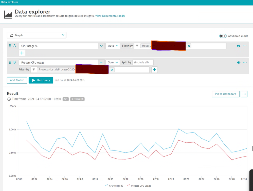

I was using the same selector than you, but discrepancies look to be higher than yours:
The absolute difference between the two values is low, but the relative difference can be very high.
This uncertainty is maybe intrinsic to the way those data are captured, because anyway usage values are quite low, it's hard to get a perfect accuracy from the linux OS itself.
Thank you again for your feedback, let's consider this topic as closed.
