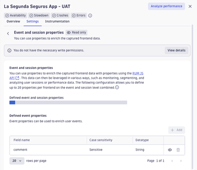

I've already define the event properties "comment" in the Dynatrace web UI.

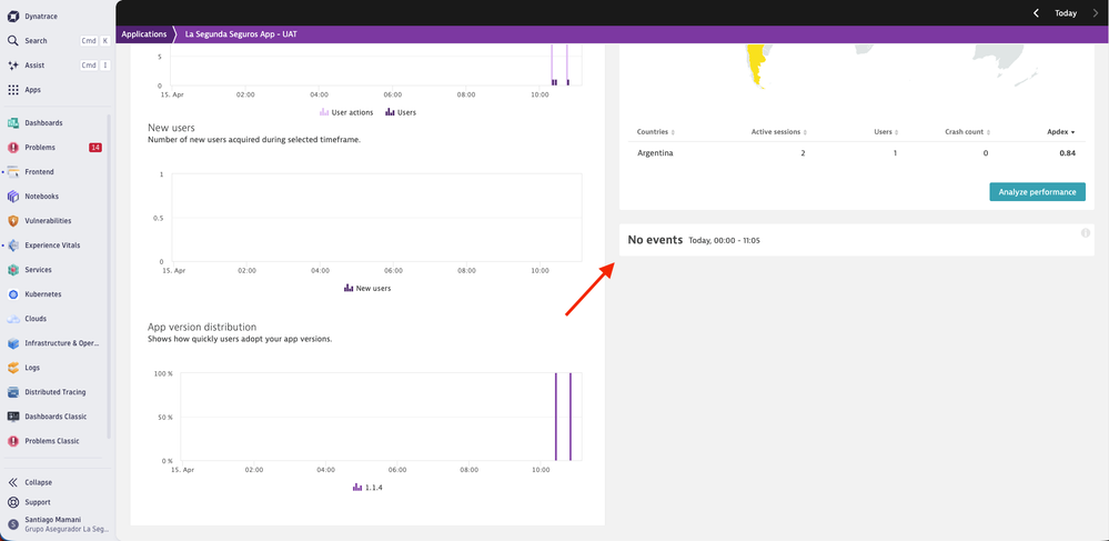

However, when I run my app and send the event, I don't see anything in the dashboard. "No events" is what I see.

The linked UI shows "events" from the root cause analysis like a Mobile app slowdown. It does not show data reported by OneAgent.

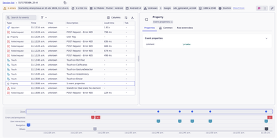

The sendEvent API is part of the New RUM Experience and this monitoring data will not be visible in the RUM Classic screens. You can see the event in the "Users & Sessions" app (you have to enable the "Property" category). And you can also query the event via DQL (in the Notebook app or as part of your dashboard).
Hi Thomas,
First of all, thank you for your quick response. I tried what you suggested, and now I can see the events!
