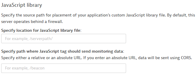

I'd like to have a dedicated container running nginx in Kubernetes, specific for serving the JavaScript agent files and receiving the beacon data from the browser POSTs. I would go into the Dynatrace application advanced settings in the UI and manually set the JavaScript library location and beacon path to match the network location of this container:
Keep in mind I wouldn't have any application or HTML being served off that nginx container, it is purely for Dynatrace RUM. OneAgent is running via the Dynatrace Operator as a daemon set on all nodes.
Does anyone know how to achieve this?

Reason I want to do a dedicated webserver is because for the applications developed in .NET Core deployed in Kubernetes, the automatic injection/reporting doesn't work as expected due to differences in the context root of the application and how it's actually exposed externally due to firewall rules.
For example, I have a service that is exposed externally under https://www.example.com/v1/app however the context root of the service is simply /, and the URI stem part of it (/v1/app) is only known to the ingress definition, and the service itself has no idea about it. So the automatic injection of the JS agent in the HTML works, however it points to https://www.example.com/ruxitagentjs to load the JS agent and https://www.example.com/rb_xxxx for the beacons, which result in 404s because neither are available under that URI path.
I can fix this by going into the advanced settings of the web application in Dynatrace and forcing the JavaScript library and beacon paths to a URI path of a service which is also instrumented with OneAgent and will result in proper 200s, however this means I am overloading this single service with all RUM tasks.
My idea is to have a dedicated container just for the purpose of serving the RUM assets and endpoints, so I am not overloading any other business services.

Try simply omitting the host name and only providing "/v1/app/" as the custom location for the JS tag and beacon.

First, you don't have to worry about overloading the application server with serving the JavaScript and listening for beacons. The RUM JS is just a static file and the beacon is just forwarded further to Dynatrace servers and there is no processing at the OneAgent.
So proper way would be to adjust those paths in the advanced section of the application.
Those values can be relative only.
I can image spinning a dedicated web server for serving the RUM JS and processing the beacons, however, the mapping has to be done by you. So basically defining ingress rules at your cluster for the /ruxitagentjs* and rb_* to point to your dedicated web server. This technically should work, but it needs this additional configuration of your ingress in K8S. Anyway, I'd recommend the first approach as it is less error-prone (no ingress rules required).

Based on how things work, you can easily set up just a plain nginx or apache and have it monitored by oneagent. The context of /ruxitagent* and rb_* will be automatically added. You only need to set up the ingress rules on the K8s so the traffic to those two URL paths will be directed to the dedicated web servers.
Oneagent on the webserver has to be connected to the same Dynatrace tenant as the monitored application.  RUM JS or the beacon endpoint can be anywhere, but they have to report to the same tenant.
So basically there is nothing to do in Dynatrace, you only have to setup your routing within k8s.

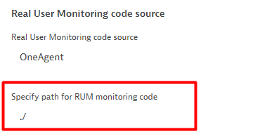

28 Oct 2025 01:33 PM
There is another simpler solution:
Both the code source and the beacon URL can be configured to ./, which allows for relative URLs without an additional path segment.
