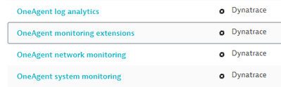

on process group i can only see below option.

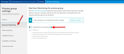

20 Jan 2023 03:18 PM
The following toggle:
20 Jan 2023 03:56 PM
Thanks , This test case we already tried and disabling RUM it comes back to normal CPU.
