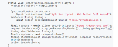

You could help yourself with automatic instrumentation or perhaps manual instrumentation (so that you have greater control of your request)
Example :

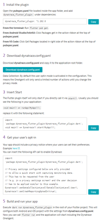

I share the Flutter instrumentation steps, in case you need them
For more information you can search here :  https://docs.dynatrace.com/docs/shortlink/flutter

Initially, I have already auto-instrumented in flutter, but we can see only the http request action.

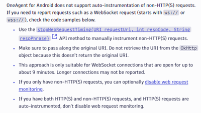

1) Our native agent supports and allows tracking of ws/wss as well. Tracking of Websockets can be done by marking start and end. Thus this makes sense for Websockets with shorter duration. If you keep your Socket connection open for a long time, this monitoring is not supported currently.
There is a documentation for Android available here: https://docs.dynatrace.com/docs/platform-modules/digital-experience/mobile-applications/instrument-a... - Basically this work similar in Flutter because the WebRequestTiming API is available there as well.

1.- In that case ( WebSocket ), manual instrumentation is necessary. And for this it is necessary to have the Dynatrace for Flutter library import.
import 'package:dynatrace_flutter_plugin/dynatrace_flutter_plugin.dart';
You may have to take into consideration some rules mentioned in ws/wss call recognition ( https://docs.dynatrace.com/docs/shortlink/oneagent-sdk-for-android#monitor-non-http-requests )

I have more question,If it's non-HTTP(s), such as gRPC, will it be able to see Networks Request?
Currently we only support http(s) and ws(s). So if the endpoint starts differently the tracking might not work as the URL validation fails on the agent side.
