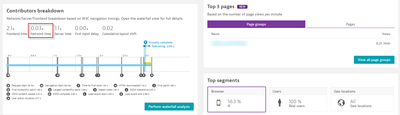

In this post I’d like to start a discussion about the metric specified in https://www.dynatrace.com/support/help/how-to-use-dynatrace/real-user-monitoring/basic-concepts/user... as a Network time. You can find it on various dashboards of the solution. For example:
This metric can be considered as an overall delay of the operation that caused by the network, but this is far not the truth. I dedicated some time to studying of this subject and came to conclusion that Dynatrace RUM, and possibly the other solutions based on W3C navigation timing, are unable to identify how network affects the operation performance. But before going further into technical details let me put couple of words about why this metric is important.

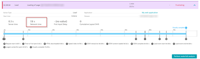

Then open one of the web pages of the business application that is instrumented with Dynatrace RUM monitoring. Here is what we can see at the Dynatrace RUM dashboards:

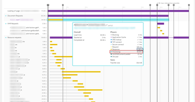

We can see a lot of heavy static object downloads, and this was the main delay of the operation, but Dynatrace assigns only 7.8 seconds at the “Network time”! I use this artificial example because anyone can repeat that. In reality, we unlikely would have 100 kbps with 1 second RTT. However, I have many practical cases when a great deal of front-end delay was coming from static objects download delay. One example was described in my previous post here, that yet did not receive any attention from the Dynatrace guru (see https://community.dynatrace.com/t5/Dynatrace-Open-Q-A/Dynatrace-RUM-metrics-meaning/m-p/171557).
The mistake can be avoided if we precisely follow up every request waterfall diagram, but this doesn’t give generalized picture that might be very helpful on the early stage of the investigation process.
