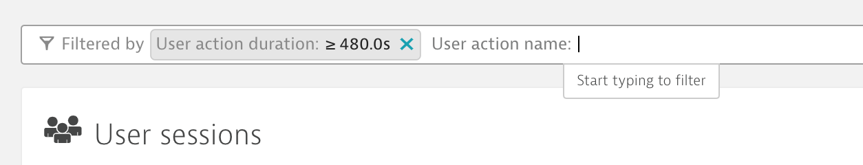

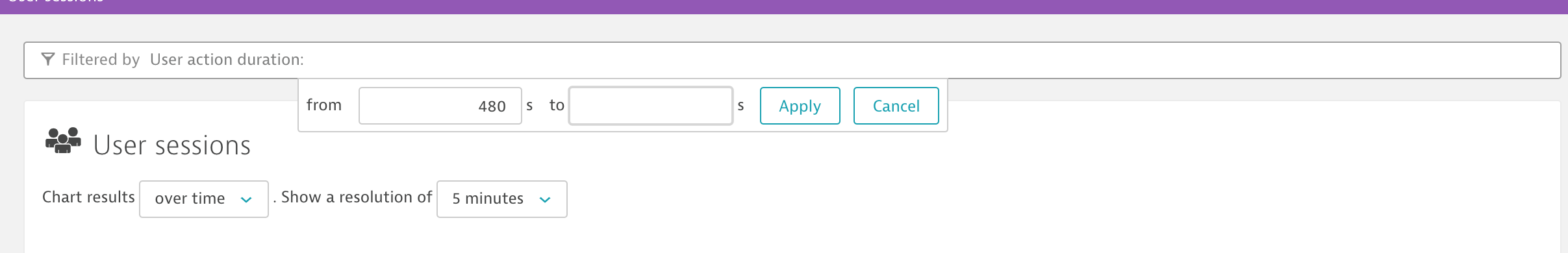

14 Dec 2018 06:39 AM
You have to start analysis from user session and find there slow user actions.
filter sessions by action duration. For such huge amount of time there should be only few. Than you will have answear which user sessions contains such actions.
If you know which action is slow (base on purepath) you can also add filter for particular user action:
This is not ideal way but the only way I know for this point. You can also do what Slavek suggested. When you will mark those long actions as Key actions, dynatrace will rise Problems correlated to such long response time and put this actions as affected. Then you will have filtered by dynatrace particular users affected problem and information about server side root cause or impact.
Unfortunately you will not go from purepath to user action right now, it was possible in Appmon, in Dynatrace at least not now. I hope it will be possible in the future.
