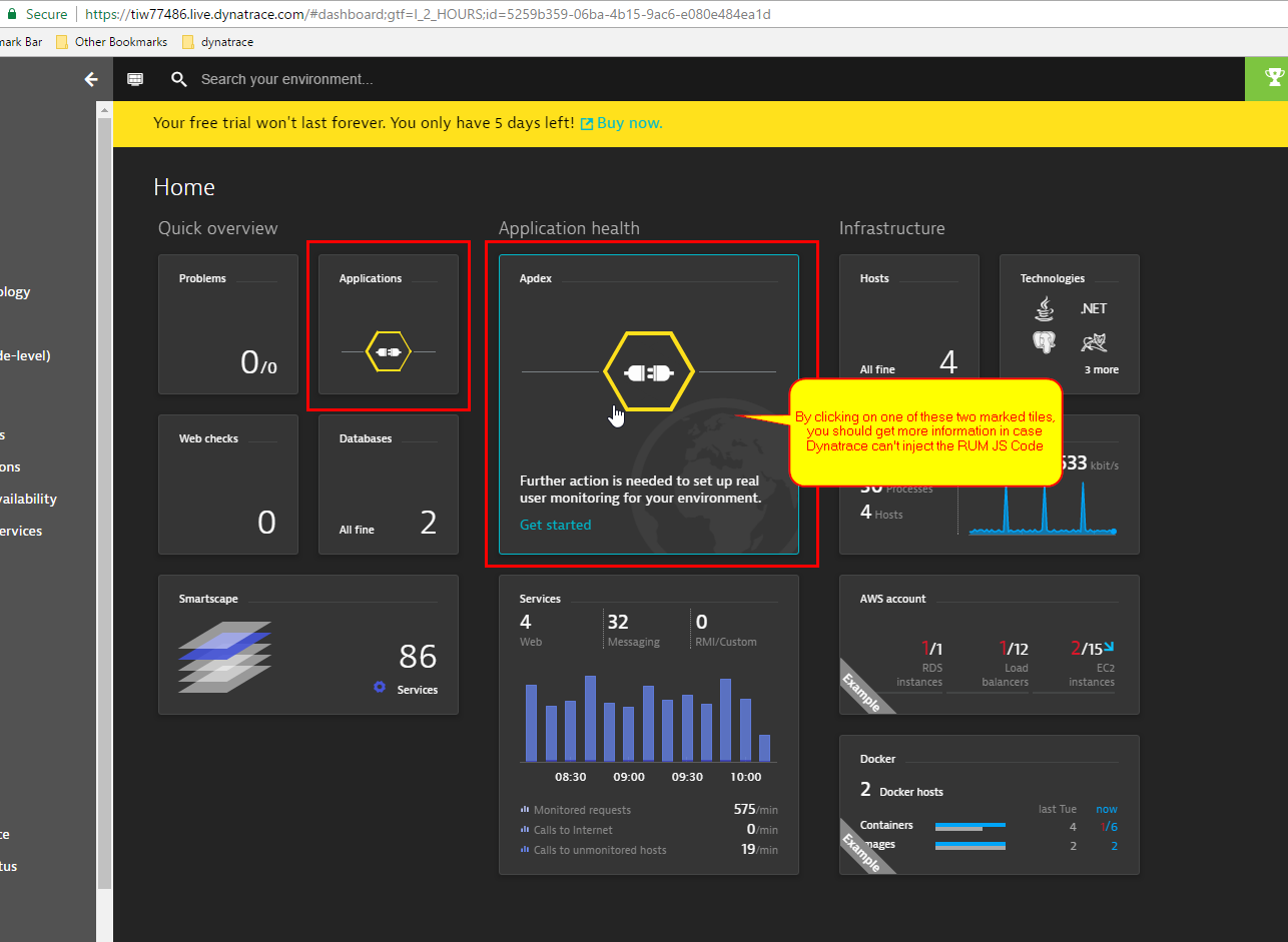

The "My web application" will appear if Dynatrace has captured the first user action. If Dynatrace detects services which deliver html and you have DEM Units for Real User Monitoring but the OneAgent can't inject the real user monitoring JS code or the beacon is not delivered back to the Dynatrace infrastructure you should see the "First success health information" in the application list or via the application tiles on your dashboard:
I would recommend to open a support ticket. The support team will take a look at your environment and will help you to identify the issue.
