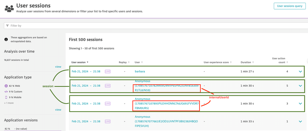

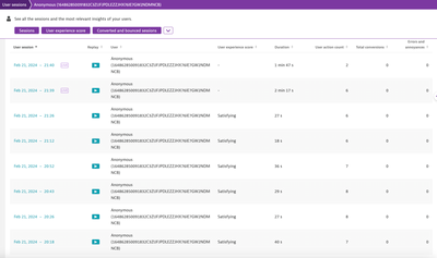

A little confused by your statement here - according to the documentation, and based on what you're describing, that description is the userSessionID, is it not? For example, when looking at this screenshot, the highlighted sections would be the user session IDs, but the internal user ID would be the individual user here, and their ID would be the same in the second screenshot as it correlates to that individual user? They should be the same if it's still the same user for that session, given all requirements have been met for the session to end.

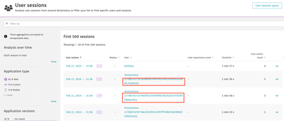

Boxed in red is the internalSessionID - am i right?
And boxed in green are the session, and they should have unique session id? or are they supposed to have the same session id?  TaylorSanchez_0-1708576865782.png
@Weilin1 ,
Yes, those that you have boxed in green are the individual sessions, where those boxed in red are the user session IDs (synonymous with the internal User ID). The same session ID is used when the cookies that follow the user on their browser correlates them with a session in Dynatrace. For easier readability into this, consider the usage of User Tags to be able to easily identify these users, even when they close out a session. The only time that this would change would be if the user changes their own internal privacy settings.
