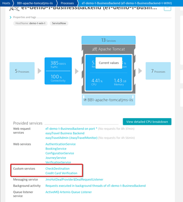

Hello, I am very new to some of this stuff so please advise if I am going totally in the wrong direction.
I am trying to view calls to/from a particular SignalR hub method. So to do this I have created a .NET Service Custom Service Detection entry point that points/references the respective SignalR Hub Class/Method and I am just wondering if I should see something different/more in the Dynatrace when users execute this method call from the respective web application and if so where would I see this in Dynatrace.

@Jam you will see it only as a service on the process itself like on the screenshot below. You won't see it in the RUM waterfall and you won't have links from the RUM waterfall to the custom service either.
