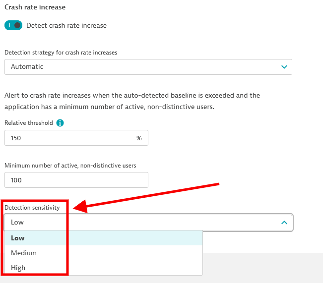

In a mobile application, the configuration for the crash rate increase has three "Detection sensitivity" values. I have tried to find what they mean, the best I have gotten is this link in the documentation, but it only mentions low & high:
https://docs.dynatrace.com/docs/platform/davis-ai/anomaly-detection/adjust-sensitivity-anomaly-detec...
I don't even know if it applies to mobile crashes. Any idea what they mean?
Screenshot for the settings page:

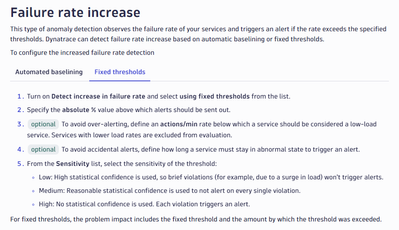

Hi.
I once tried to understand the mechanisms under automated baselining, so I remembered seeing those thresholds somewhere...
I have found the following documentation, I hope it will guide you in the right direction
So, from "Settings API - Crash rate increase settings for mobile applications schema table", you immediately have the link to Automated multi-dimensional baselining.
And as it also made sense to look for "adjust sensitivity", I got to
Adjust the sensitivity of anomaly detection
and for instance in
Adjust the sensitivity of anomaly detection for services
Hope it helps
18 Mar 2024 08:29 PM
Thanks! In the first link I had previously verified that it was an enum, but there is no reference what actual values are permitted.
I had also seen the second link (the one I linked to), but it only has two sensitivity levels, and no reference to the "medium".
Your third link I had not found, and although not immediately related to crashes, and implying fixed thresholds, it explains "medium" is something in the middle of Low & High, which quite frankly is what I was expecting too 🤣
Thanks for finding this out.
