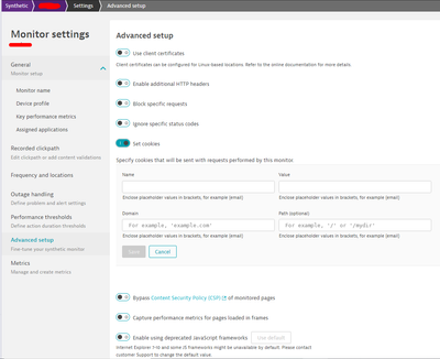

Have you tried setting the cookie in the "Advanced Settings" settings and tested if it works?
Regards,
Elena.
@erh_inetum, thank you for your response.
Cookie is already added under advance setup for
firsttest.xyz.com domain
However, I want to trigger on-demand for another domain
i.e. test.xyz.com
This would be having different cookie value.
What I need a help with how can we pass the cookie in request body for on-demand execution?

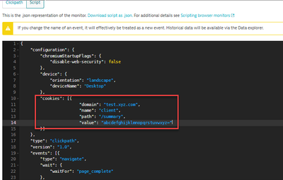

Basically, I'm looking to add cookies which we add under advanced setup. This can be seen under configuration section when we go script mode of synthetic monitor like below,
Regards
AK

The script configuration section cannot be customized. The list of events that can be customized can be found here but you can customize a cookie step, so you could add a cookie event to the monitor and then modify that on the fly.
