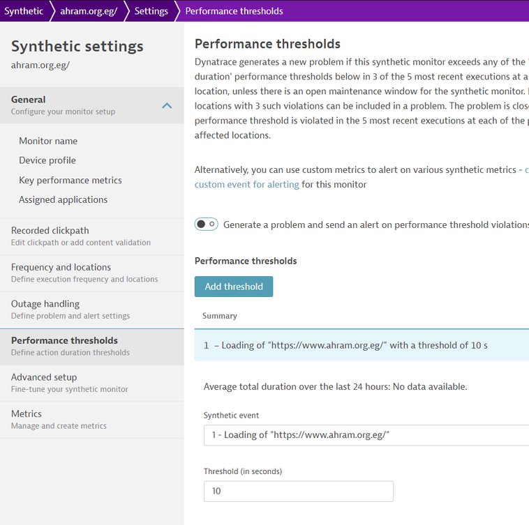

did you tried to set the performance threshold for the action to be as expected ? see the following figure

Hi @Manisha_K , this event gets triggered when the wait time for the page to load exceeds the default or specified timeout value.
Default wait time for a page to load completely is 60 seconds. If the page does not finish loading within this time frame, the event will trigger, indicating that the time exceeded waiting for the page to load completely.
See below link for details on error codes
https://community.dynatrace.com/t5/Troubleshooting/Synthetic-Browser-Monitor-Error-Codes/ta-p/198177
There could be different reasons for this event being triggered , ex., network conditions , page resources , performance issues etc.,
You can start by adjusting timeout settings for this page if needed (see below)
https://docs.dynatrace.com/docs/shortlink/id-brower-clickpath-events#wait
