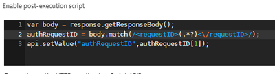

15 Nov 2022 08:23 PM
I can confirm that you can use regex in the post-execution synthetic script. Here is who I did it for our application.

22 Sep 2023 09:01 AM - edited 22 Sep 2023 09:02 AM
I was able to extract the value of policyNo from the response body.
In case anyone is interested or has a similar challenge in future, here is the post-execution script I used:
