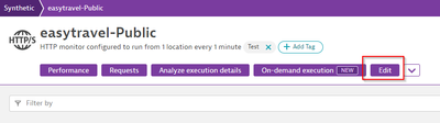

for an existing monitor you can click on "edit" and select "Frequency and locations" in the monitor settings menu.
There you can change the frequency. For http monitors it is possible to choose between 1 min and 60 min. For browser monitors it is to choose possible between 5 min and 4 hours.

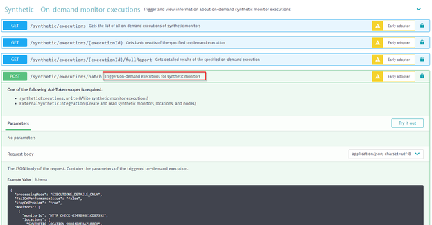

Please check the environment API v2. There you should have an option to trigger on demand executions:
I already linked to the documentation in the other post. You might be able to solve it via a script, so that you trigger the monitor via the API every 8 or 12 hours.

If you only want to run the monitor every 8 or 12 hours, you might be able to solve it using the on-demand function. Please also check the API section in the linked documentation.
