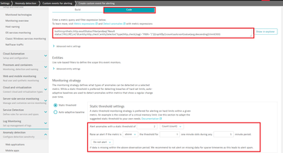

Can you do what you want with Custom events for alerting?
Create 3 separate HTTP Monitors.
1) For 'warning' when only 1 endpoint fails, use either the global or local outage settings in the HTTP Monitors. See docs.
2) For the All down problem, create a 'custom event for alerting'. I tagged all three of my HTTP Monitors with 'HMA' and then used this metric expression to combine them.
builtin:synthetic.http.resultStatus:filter(and(eq("Result status",FAILURE),in("dt.entity.http_check",entitySelector("type(http_check),tag(~"HMA~")")))):splitBy():count:auto:sort(value(avg,descending)):limit(100)
I then set the static threshold to alert when the count went over 2.
