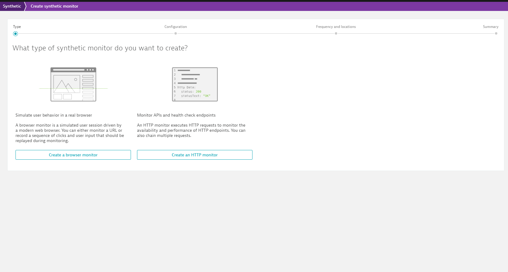

I'm trying to follow this tutorial https://www.dynatrace.com/news/blog/explore-and-analyze-amazon-cloudwatch-synthetics-data-in-dynatra... but when I get to the "Then, to begin importing the CloudWatch Synthetics data" step and try to create a synthetic monitor, I don't see any "Explore the Options" link anywhere. This is all I see
Any idea what's going on here?

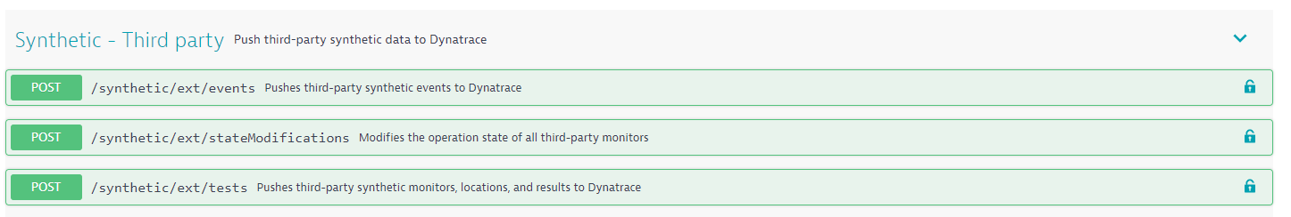

@David F. with the most recent cluster update: 1.209, it appears that there is a section for 3rd party synthetic data now:
If you are managed, the cluster update is about 2 weeks behind SaaS users.
