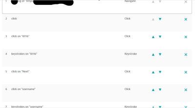

Hi Community, I am always stuck at some point, & you always helped me out.
How can I solve this issue - Playback error: Multiple selectors were not found.  & add an extra CSS element so this will not come in future playbacks. I dont understand Json/css/html/scripts so much.
What to do Change or Add in CSS element locator to mitigate this error?
Can you please help me with an example,
Thanks in advance.
5 REPLIES 5
AntonPineiro
Do you have details about before events? Maybe it is trying making click before that input field is rendered.
It that website public available?
Best regards
Yes it has before events
how do I change the CSS elements for which paths I am confused
Adi_10
Guide
i have made changed on above events to wait until next event to load and this solved the issue.
But Question - Remained as - HOW DO I CHNAGE/ADD THE CSS ELEMENT IN CLICK PATHS.

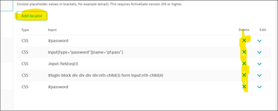

Re-using your before screenshot, it would be there:
Best regards
HannahM
Dynatrace Guru
Dynatrace Guru
You can find the documentation for updating locators here:
https://docs.dynatrace.com/docs/observe/digital-experience/synthetic-monitoring/browser-monitors/bro...
