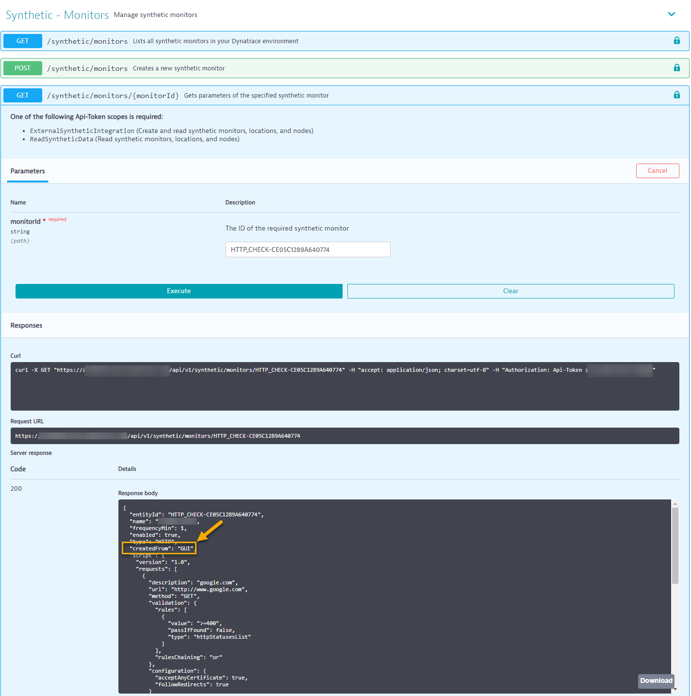

Is it possible to get info who created script and who did last change ?

So there are two options in the UI. You can get the details of a synthetic monitor but it wont give you the creator, more so where it was created from, The API/UI etc...
Th other method is to use the audit log API. Here you can see who created it, edited etc... as well as when it was created.
Granted the audit log api has its limitations. Hopefully dynatrace improves the capabilities in the near future.

Great - will the audit log API possibilities 🙂
Thank you Chad !
