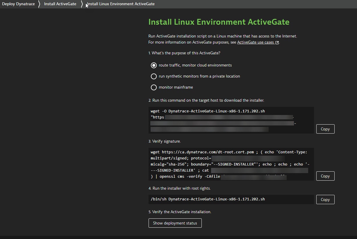

Hey Ryan, Yes We have done this for CMC activegates that handle oneagent traffic, Mobile app alerts, internal synthetics, external synthetics, and custom plugins. I have attached a screen shot with the settings we use when we download the linux install/updated version.
You could select that second radio button and it will pass the perams for synthetics but i dont believe thats needed since synthetics are already running - the install file just updates
Everything we have tried has worked as expected in regards to upgrades, except for the second option in your screenshot. When we run the install with the parameters it mentions, the install fails telling us that parameters are not needed. Then when we run it with no parameters, it blows away synthetics and turns the activegate into the first option (route traffic, monitor cloud environments). I am going to try it with the option Yos mentioned above with the modification to the custom.properties file, and I'll report back.
