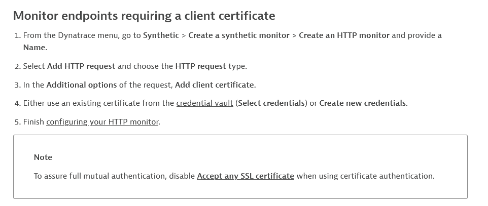

Check out at the end of https://www.dynatrace.com/support/help/how-to-use-dynatrace/synthetic-monitoring/general-information...

23 Jun 2022 09:51 AM
Now that you make that questions, I've figured out that my reply might not be your use-case. I was referring to the configuration of client-certificates, which is a different topic...
23 Jun 2022 09:28 AM
@mhlamine answer to your second question would be it uses credential vaults to check for trusted certs. Yes it does add needed headers using certs for request.
It will be completely optional for additional header values.
