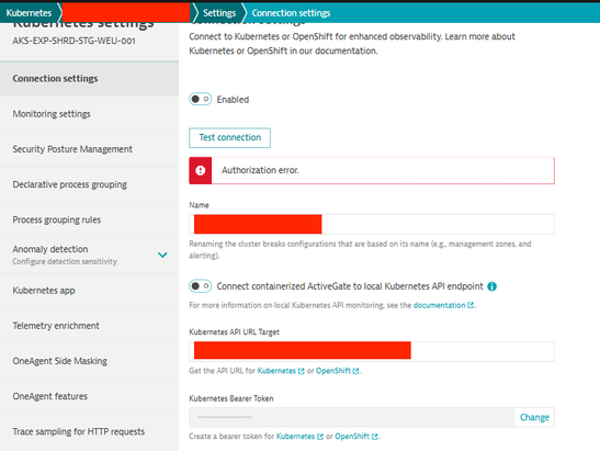

When connecting to a Public Kubernetes endpoint manually, you are facing an "Authorization" error as shown below:
It can denote there are problems with the Bearer Token that you are using to connect to the Kubernetes Endpoint, or there is a Firewall/Proxy in place that is restricting the traffic.

When the user tries to connect to their Public Kubernetes endpoint, clicking on "Test Connection" gives 'Authorization Error'.
