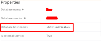

  3. Even after installing Oneagent in host where Database is running, you still see a message (host_unavailable) in database properties as below:
  • Check whether host name and port number if they are being read by “sqlhosts” file. “SQLH_TYPE=FILE;SQLH_FILE=/deployments/config/sqlhosts
  • If yes then the OneAgent cannot access local configuration files. Thus, the OneAgent cannot resolve the name of the host
  • You would need to check the JDBC connection string if the HOST name is visible in that and Oneagent can then capture the Host name value to display in Properties.
  • There is a mechanism for routing the connection where JDBC sensor of Oneagent should be able to extract the Hostname(DNS resolved) or by IP address from the JDBC connection String.
