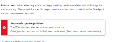

Scenario 1.
This happens in Windows machines.
This is not a Dynatrace issue; the error message points to the MS error code, which can happen for many reasons. For more details, please check the page below.
MSI installation error 1603 - Windows Server | Microsoft Learn

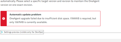

Scenario 3.
This is a self-explanatory issue; the updates can fail due to insufficient disk space.

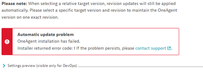

Scenario 4.
 This issue happens in Linux hosts; this can be due to many reasons.
Running the health check will show the details.
./oneagentctl --healthcheck

Hi, about scenario 3, how can we check in advance if a host has sufficient disk space?
My idea is to run a check 2 weeks before oneagents update to detect hosts on which to increase disk space when it is insufficient.
Thanks
noel_david
Dynatrace Helper
Dynatrace Helper
Hi Paolo,
The logic of checking if there are enough spaces is invoked during the update/installation step. As of now, it's not possible to check the disk space in advance.
But this page will be helpful.
https://docs.dynatrace.com/docs/shortlink/oneagent-disk-requirements-windows#updates
