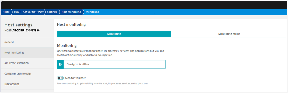

As the first step it would be required to get HOST ID from the log file:
2026-01-00 00:00:15.732 UTC [00175140] info    [native] OSI ID ...................... 0xABCDEF1234567890
and then navigate to Host monitoring settings page the Monitroing this host toggle may be turned off: https://<tenant_id>.apps.dynatrace.com/ui/apps/dynatrace.classic.hosts/ui/settings/HOST-ABCDEF1234567890/builtin:host.monitoring
However, if the host cannot be enabled by turning on the toggle or the host entity wasn't created, please use the Settings API to retrieve all objects for this schema ID - builtin:host.monitoring.
  • Settings API - GET objects
    curl -X 'GET' \
      'https://<tenant>.live.dynatrace.com/api/v2/settings/objects?schemaIds=builtin%3Ahost.monitoring&fields=objectId%2Cvalue&adminAccess=false' \
      -H 'accept: application/json; charset=utf-8' \
      -H 'Authorization: Api-Token <API TOKEN>'​
  • and then to enable monitoring - Settings API - PUT an object, send a request with the next body:
        "schemaId": "builtin:host.monitoring",
        "scope": "HOST-ABCDEF1234567890",
        "value": {
          "enabled": true
        "scope": "HOST-ABCDEF1234567891",
        "value": {
          "enabled": true
