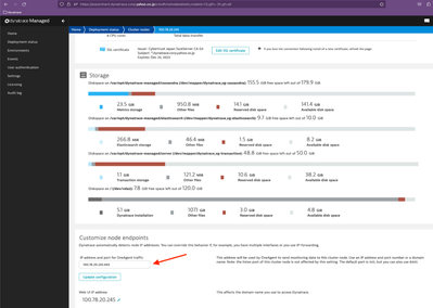

How do we change the default port settings to 443 from 8443 for the cluster that set up a cluster version earlier than 1.166? Changes in the required file. The mentioned steps need to be followed. NA
  • Environments preserve port settings from the previous versions.
  • Cluster version later than 1.166 exposes port 443 for incoming access from OneAgent as default.
  • There is no API or automated way of configuring the port setting for new nodes that get added to the cluster, i.e. They need to be manually configured from the CMC page as shown in the below screenshot.
