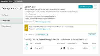

  6. The hex column contains the ActiveGate ID in hexadecimal format.
    Copy this hex value and use it to search on the Deployment status > ActiveGates page to find the exact ActiveGate that ran the Browser Monitor execution.
