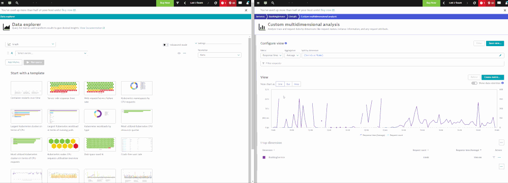

Here is a short demo of the service Not showing any Percentile data in Graph, Stacked visualisation
  • In this, I created a Calculate service metric(Authentication service) and selected Split by Service
  • After running the query, it the default aggregation shows Auto(avg) for response time.
  • Now if you observe it carefully, I am changing the aggregation to Percentile but the values are not changing in Graph.
  • This is because the Calculated Service metric doesn’t support Graph, Stacked visualization or visualization that has multiple data points.
  • Percentile will only work for combined or merged data points like, PIE/Honeycomb/Table/TOP list.
  • Below you will find the alternate workaround for getting percentile value for Calculated service metric.

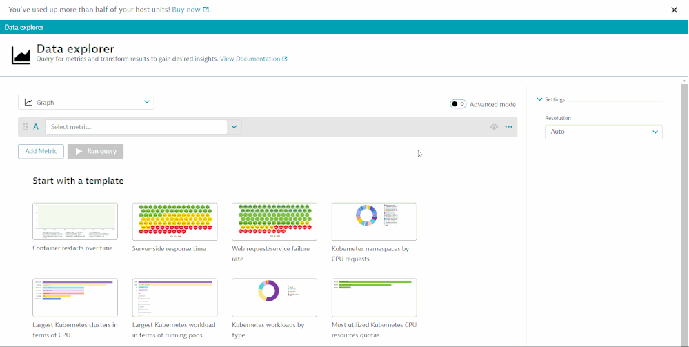

    • Open Data explorer and change the Visualization to Table/TOP/Single view.
    • Also open MDA for that service that you want to compare the value with(optional)
    • Search for  Calculated service metric in Data explorer and switch to Advance mode.
    • Reason for advanced mode is because you will options to modify the percentile value same as in MDA.
    • Now run the query and also update the value in MDA to compare.
    • You will find almost similar value(not 100% same but close enough) for the service.
