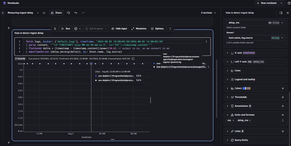

A better approach is to query the affected table or bucket, and aggregate a count over the timeframe, to check how data was backfilled. You can compare timestamps in the message of records, use DPL to extract the timestamp from messages, and calculate and graph a delta to the ingest time, like now(), called during log processing in OpenPipeline, and set to a field like delta. The higher that delta, the more data of that type and source was stored with that delta between creation and ingest times. For example, a log with a message timestamp of 9 AM and a timestamp field or time of ingest of 11 AM was buffered and sent 2 hours late, but stored at the time of ingest, not backfilled to the time of creation. Consequently, a gap exists where teams would expect to find their data, and they may have to shift their query timeframe by the delta to see that data. When we calculate delta, the time of ingest or calling now() in a processing rule, is always expected to be greater than the time of a supported timestamp format extracted from content.
fetch logs, bucket: {"astroshop_log_bucket"}, timeframe: "2026-09-01 08:00-6/2026-09-01 14:00-6"
| parse content, """LD TIMESTAMP("yyyy-MM-dd HH:mm:ss.S", tz="UTC"):timestamp.content"""
| fieldsAdd delta = (timestamp - timestamp.content)/power(10,6) // output is ns, so you convert to ms
| makeTimeSeries {delay_ms=avg(delta)}, by: {host.name, log.source}
Notebook query showing example of how delta calculation on demand works

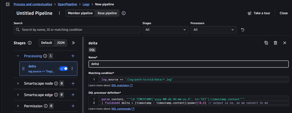

  3. Add a custom pipeline and add processors.
    1. Processing stage > Add a DQL processor for delta calculation. Check the Conversion Patterns in DPL Time and Date to build the patterns for timestamps in your data messages, like "yyyy-MM-dd HH:mm:ss.S". Please also note that you must set the time zone, like tz="BST", or OpenPipeline will extract as UTC from the message. The provided example includes a generic DPL expression, but you should review your log sources, and add as many delta processors with matching timestamp and DPL expression as needed, checking if isNull(delta) before execution of each one.
      parse content, """LD TIMESTAMP("yyyy-MM-dd HH:mm:ss.S", tz="CET"):timestamp.content"""
      | fieldsAdd delta = (timestamp - timestamp.content)/power(10,6) // output is ns, so we convert to m
