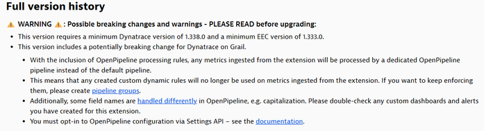

Check extension release notes (This change will be marked as Breaking change in release notes with text similar as one on the picture below)
One version below the version with breaking changes will be the one that you need to install

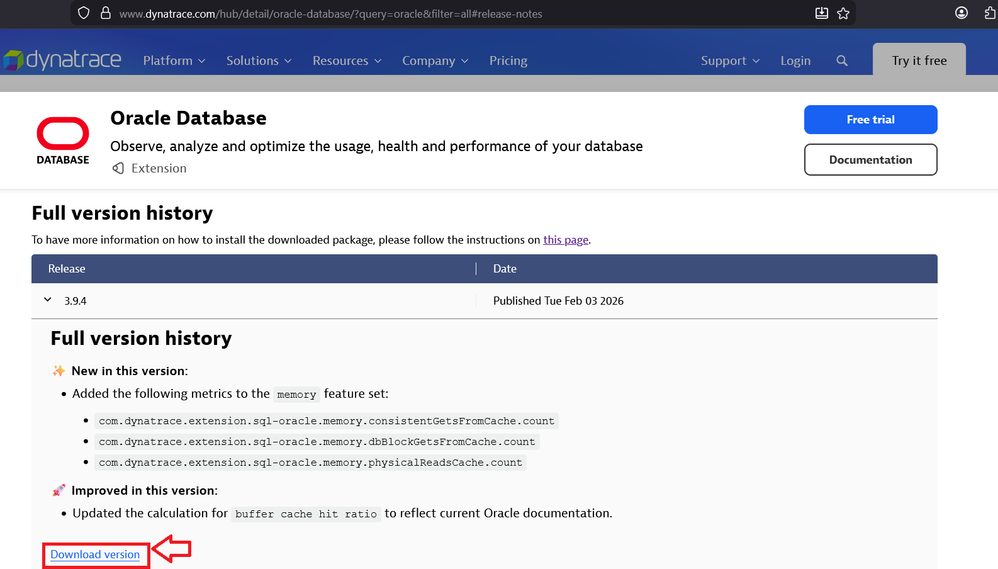

  1. Get the extension package file you want to upload. One way to obtain it is through the Dynatrace Hub (Official Site). Navigate to the release notes for the desired version and download the package file:
