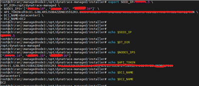

Set the required environment variables on every node in both datacenters. Below is a template for the variables you need to configure:
  • SEED_IP=x.x.x.5 – (IP address of the DC1 seed node)
  • DT_DIR=/opt/dynatrace-managed – (Directory where Dynatrace binaries are located)
  • NODES_IPS=$(echo '["x.x.x.14", "x.x.x.15", "x.x.x.16"]') – (List of DC2 node IPs)
  • API_TOKEN=dt0c01.GJBLXR5JSOBAZZDND355S2R3.xxxxxxxx – (API Token with ServiceProviderAPI scope from CMC)
  • DC1_NAME=datacenter1 – Consistent name for DC1 (confirm using ./cassandra-nodetool.sh status)
  • DC2_NAME=DC2 – Name for DC2 (can be any preferred value)

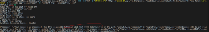

Step 7: Firewall Rule Configuration for DC2

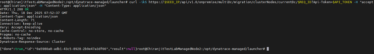

Open the required firewall rules for DC2 nodes by executing the following command from the DC1 seed node:
curl -ikS -X POST -d "$NODES_IPS" https://$SEED_IP/api/v1.0/onpremise/multiDc/migration/clusterNodes/currentDc?Api-Token=$API_TOKEN -H "accept: application/json" -H "Content-Type: application/json"
Take note of the REQUEST ID generated by the above command, as it will be required in subsequent steps. Set this as an environment variable on the SEED node:
export REQ_ID=<Generated REQUEST ID>
Verify that the firewall rule has been applied; the status should be 200

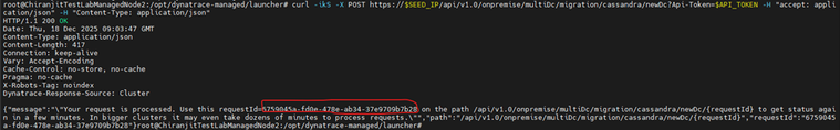

Step 9: Cassandra Replication

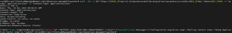

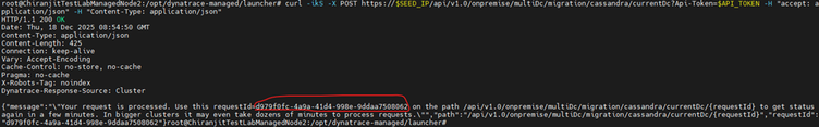

Initiate Cassandra replication from DC1 to DC2 by running the following command from the DC1 seed node. The response should include a status of 200 and will generate a Request ID, which should be set as an environment variable on the SEED node.
curl -ikS -X POST https://$SEED_IP/api/v1.0/onpremise/multiDc/migration/cassandra/currentDc?Api-Token=$API_TOKEN -H "accept: application/json" -H "Content-Type: application/json"
Check the replication status from the DC1 Seed Node; the status should show as 200

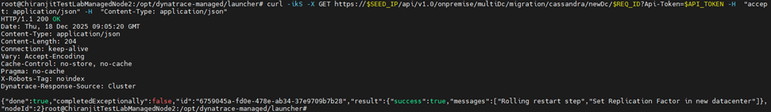

To initiate replication with DC2, use the command below from the SEED node. Set the new Request ID as an environment variable and check the replication status for DC2, ensuring a 200 response
curl -ikS -X POST https://$SEED_IP/api/v1.0/onpremise/multiDc/migration/cassandra/newDc?Api-Token=$API_TOKEN -H "accept: application/json" -H "Content-Type: application/json”
Check the Replication status from the Seed node for DC2; this should be 200 status.
curl -ikS -X GET https://$SEED_IP/api/v1.0/onpremise/multiDc/migration/cassandra/newDc/$REQ_ID?Api-Token=$API_TOKEN -H  "accept: application/json" -H  "Content-Type: application/json"

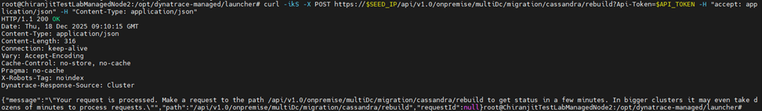

Rebuild Cassandra on the DC2 node by executing the following command from the SEED node. This rebuild might take a few minutes to hours, depending on the database size
curl -ikS -X POST https://$SEED_IP/api/v1.0/onpremise/multiDc/migration/cassandra/rebuild?Api-Token=$API_TOKEN -H "accept: application/json" -H "Content-Type: application/json"

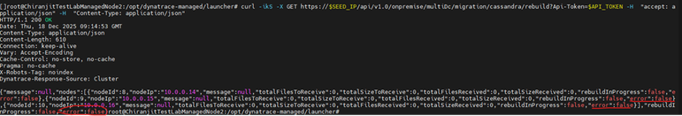

Monitor the rebuild process using. The rebuild is complete when the response contains "error:false".
If "error:true" appears, consult Dynatrace support.
curl -ikS -X GET https://$SEED_IP/api/v1.0/onpremise/multiDc/migration/cassandra/rebuild?Api-Token=$API_TOKEN -H "accept: application/json" -H "Content-Type: application/json"

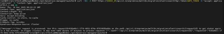

Step 11: Elasticsearch Replication
Start Elasticsearch replication in DC2 nodes by running the following command from the SEED node. This will generate a REQUEST ID to be set as an environment variable
curl -ikS -X POST https://$SEED_IP/api/v1.0/onpremise/multiDc/migration/elasticsearch?Api-Token=$API_TOKEN -H "accept: application/json" -H "Content-Type: application/json"

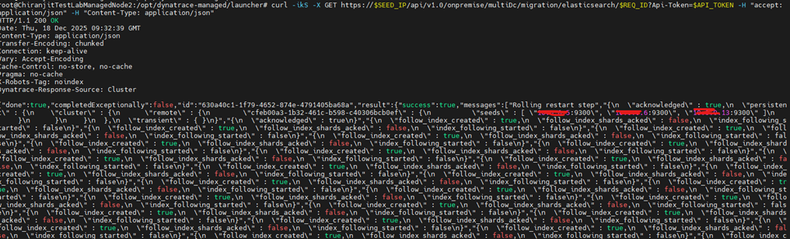

To monitor progress, run The replication should show 200 status and the response should look like the screenshot below
curl -ikS -X GET https://$SEED_IP/api/v1.0/onpremise/multiDc/migration/elasticsearch/$REQ_ID?Api-Token=$API_TOKEN -H "accept: application/json" -H "Content-Type: application/json"

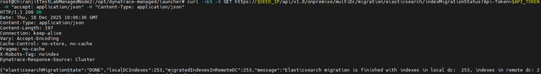

To further verify data replication, execute it. It should return a 200 status and a message as "Elasticsearch Migration is finished..."
curl -ikS -X GET https://$SEED_IP/api/v1.0/onpremise/multiDc/migration/elasticsearch/indexMigrationStatus?Api-Token=$API_TOKEN -H "accept: application/json" -H "Content-Type: application/json”

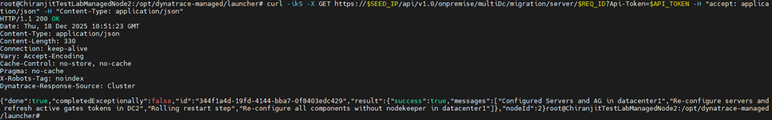

Step 12: Server Migration and Service Startup in DC2

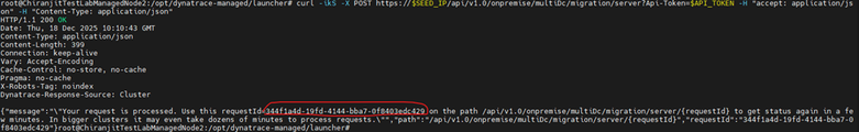

Begin the server migration by starting OneAgent and NGINX on the DC2 nodes. Run the following command from the SEED node to start the migration and generate a REQUEST ID, which must be set as an environment variable to verify cluster readiness:
curl -ikS -X POST https://$SEED_IP/api/v1.0/onpremise/multiDc/migration/server?Api-Token=$API_TOKEN -H "accept: application/json" -H "Content-Type: application/json"
To check cluster readiness, execute the command below. This will take some time to show 200 as it is starting the services in the DC2 nodes
curl -ikS -X GET https://$SEED_IP/api/v1.0/onpremise/multiDc/migration/server/$REQ_ID?Api-Token=$API_TOKEN -H "accept: application/json" -H "Content-Type: application/json”

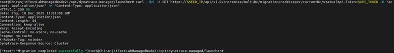

Step 13: Nodekeeper Migration

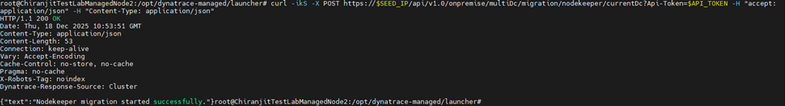

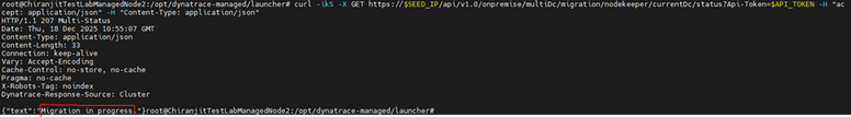

Finally, migrate nodekeeper by executing the following command from the DC1 Seed node.
curl -ikS -X POST https://$SEED_IP/api/v1.0/onpremise/multiDc/migration/nodekeeper/currentDc?Api-Token=$API_TOKEN -H "accept: application/json" -H "Content-Type: application/json”
Check the migration status using. Allow some time for the status to update to 200, confirming successful migration
curl -ikS -X GET https://$SEED_IP/api/v1.0/onpremise/multiDc/migration/nodekeeper/currentDc/status?Api-Token=$API_TOKEN -H "accept: application/json" -H "Content-Type: application/json”
