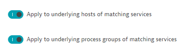

Check the Tagging / Management Zone Rules: This setting indicates that the affected entity inherits the Tag or Management Zone rules from another entity. You may turn this off and disable the propagation by following these steps:

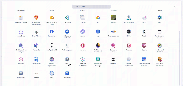

1. Go to Settings > Preferences > Management Zones
2. Select the appropriate Management zone rule
3. Verify if the following settings are turned on
4. Turn off these settings and disable the propagation.

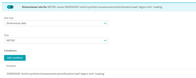

Check the dimensional rules: If the problem is Metric-Based Event, it is possible that there are dimensional rules that is adding the metric to the management zone, hence, adding tags or management zones to the problem card.
For example:

tijust1
Advisor
@jellypunoThank you for sharing this. I have a question: Does this imply that the best practice is to create conditions separately instead of enabling toggles for both services and processes in one condition, such as inside the host monitoring rule?"
jellypuno
Dynatrace Helper
Dynatrace Helper
@tijust1 Yes, that is the ideal approach.
