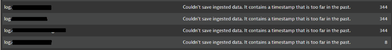

Some applications, including OneAgent processes, may timestamp logs in timezone UTC instead of the local host's timezone, which may cause issues with metric and event extraction in Dynatrace pipelines. Metrics and events are time sensitive data sets, so any logs that are older than an hour will be ignored for metric extraction and any events older than 15 minutes when they are created may not generate any alerts.
For classic metric extraction that stores metrics in our classic storage, our preset classic dashboard Metric & Dimension Usage + Rejections will show discard reasons, for example, rejections that cause gaps because data is too far in the past.

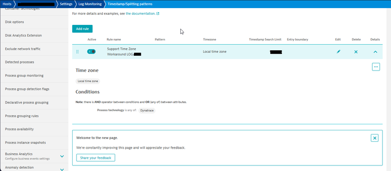

We can resolve issues related to metric gaps or missing alerts on events of extraction on logs by configuring a timestamp rule with the correct timezone. If your app's logged timestamp pattern is recognized by the OneAgent as evidenced by Diagnostic statistics, we don't have to add a timestamp pattern to our rule using format specifiers.
We can add a timestamp rule in classic Settings > Log monitoring > Timestamp/splitting pattern with at least:
  • the timezone set the local server time or the timezone of your app logs.
  • a condition matcher to limit the scope of the rule to only your affected log source.
We don't need to override the timestamp search limit unless your timestamp patterns are more than 64 bytes from newlines, or we want to ignore your timestamp patterns in content with a timestamp search limit of 0 bytes.
