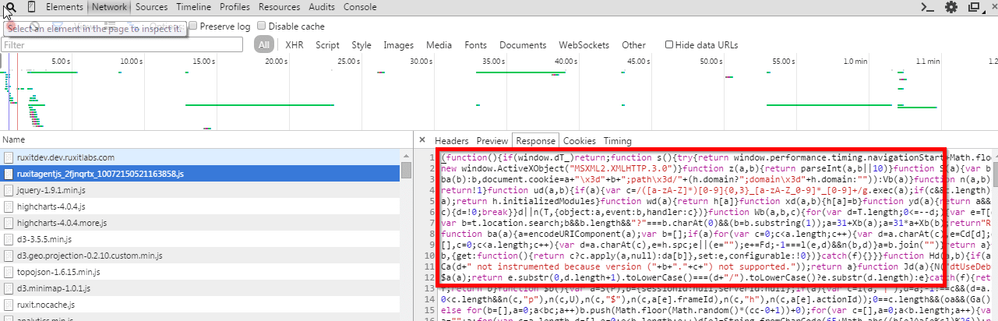

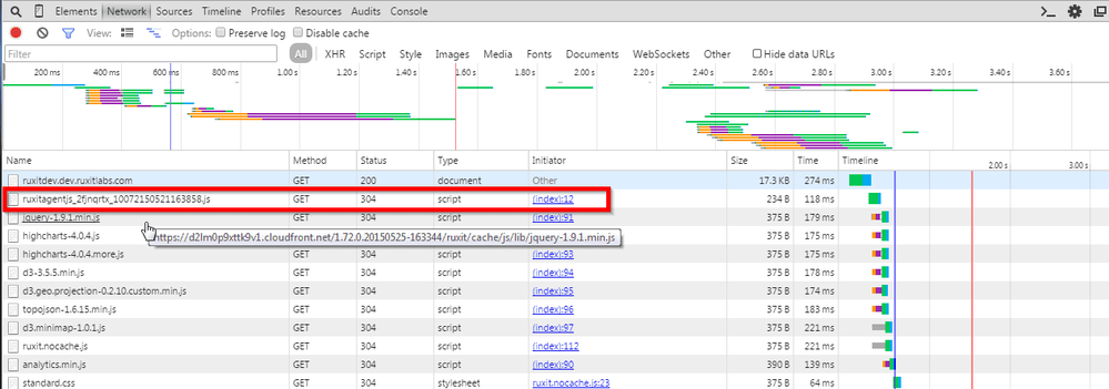

The Dynatrace RUM JavaScript is downloaded along with the other resources of your web page. To confirm that the download was successful, open the Network tab in your browser’s developer tools. Look for a request URL that contains one of the following strings:
The response should have a 200 OK status and the body should contain JavaScript code.
An example is shown in the screenshots below.
If the RUM JavaScript hasn't downloaded correctly, refer to RUM JavaScript isn't downloadable.

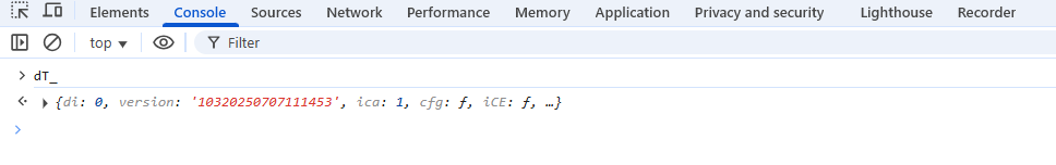

To check if the RUM JavaScript has initialized successfully on your page, check whether the dT_ JavaScript object exists. Open your browser developer console, enter dT_, and press Enter. As a result, an object should be returned. Otherwise, you will find logs in the browser console that help you identify the issue.

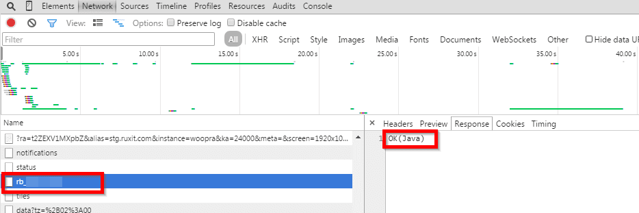

If the beacon requests are handled by OneAgent, look for requests with a URL where the path begins with rb_.

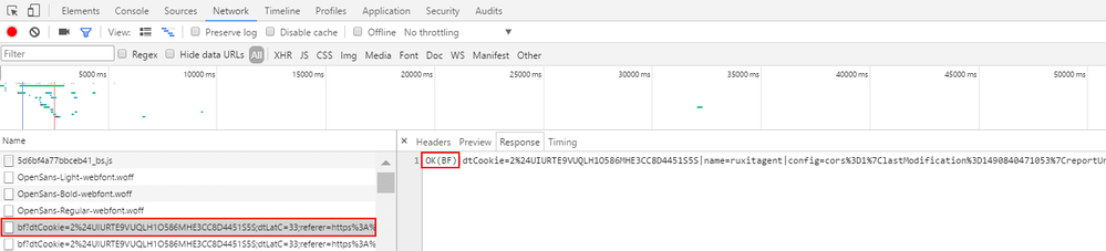

  • If you are using Dynatrace SaaS, beacon requests go to Dynatrace, and their URL path begins with bf.
  • If you are using Dynatrace Managed, the requests are directed to a domain in Dynatrace Managed, and their URL path begins with bf.
Responses should have the 200 OK status, and the response body should start with OK. If the response body starts with FL, the RUM beacon was rejected and not forwarded to the server. The response contains additional information about the problem. For further details, check RUM JavaScript doesn't report data to server.
