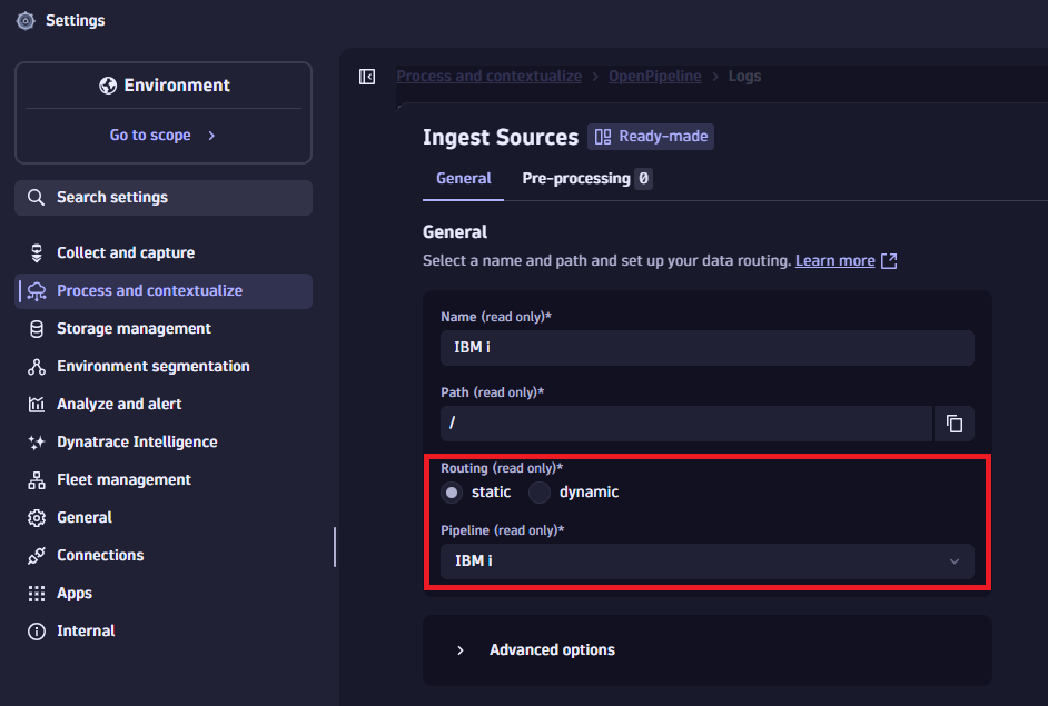

Ingest source of an extension shows static route to a read-only, readymade pipeline.
Problem
Newer releases of extensions own a dedicated readymade pipeline with a statically routed Ingest source. This extension owned ingest source supersedes the generic, built-in Extensions ingest source, which sends data to Dynamic routing. After an upgrade of a monitoring configuration in the extension, dynamic routes that we added for that source's logs report 0% distribution, and matching log processors in our custom pipeline stop working, because the new static route sends all logs of the extension's monitoring configurations to the extension's own Readymade pipeline, before dynamic routing can be evaluated.

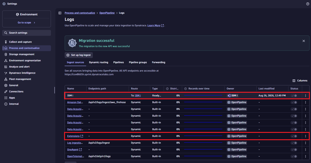

Distribution of logs from ingest sources.
When identifying why processors stop working, we should check for Ingest sources that sends data along a static route in OpenPipeline. We can review:
  • Revision history on the readymade pipeline to confirm when it was created or re-created, which often aligns with an updated monitoring configuration that installs the newer extension release.
  • Revision history on a classic log event rule can confirm the owner, so we know if we should manually migrate. Only rules created by an extension may be re-created in the Readymade pipeline.
  • If logs are stored in an unexpected bucket, processed by an unexpected pipeline, or processing stops working, that is a possible indicator that a new Ingest source is bypassing our Dynamic routing by sending the data along a static route.
When working with Ingest sources sources sending data along a static route in OpenPipeline:
  • A generic catch-all Ingest source like Extension is superseded by extension-specific Ingest sources, like that of SQL Server or IBM i.

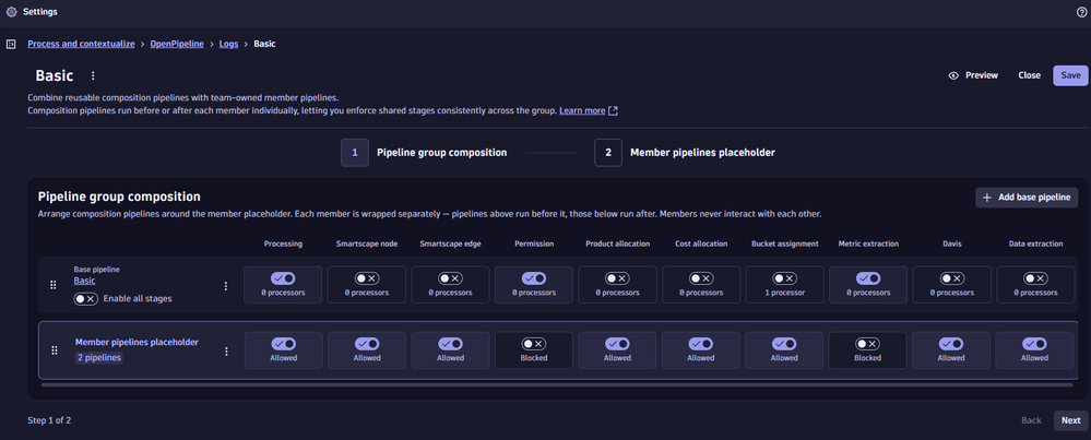

To resolve this scenario for Readymade pipelines, you should add the Readymade pipeline to the composition of your pipeline group, then add your base pipeline.

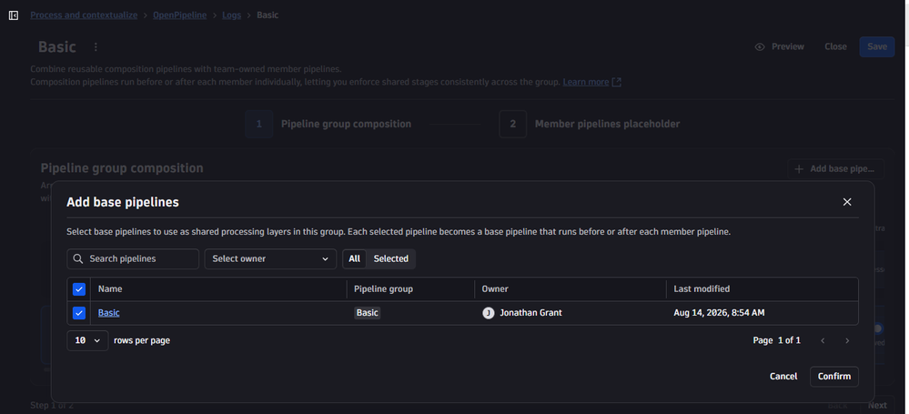

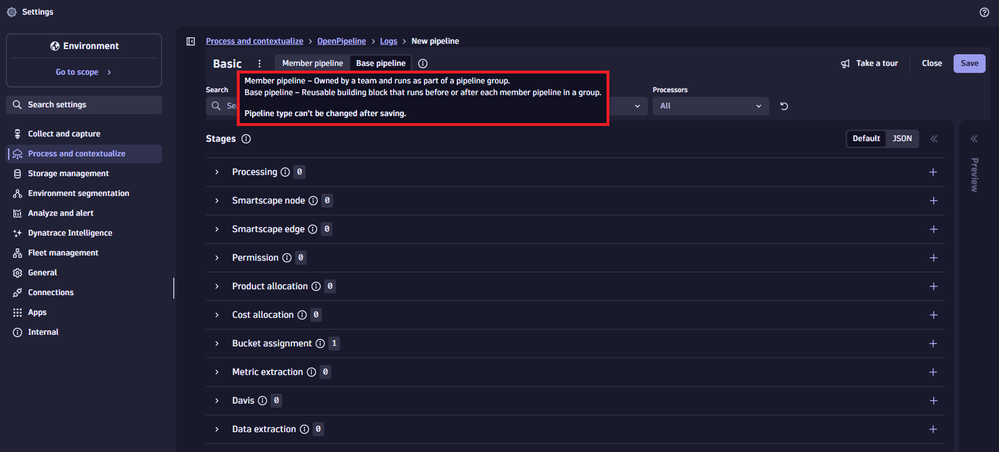

  1. Confirm that your custom pipeline is a base pipeline that you can add to your pipeline group.
    IBM i Readymade member pipeline is read-only for admin user role, so check that your custom pipeline is selected as a base pipeline.
    1. Only base pipelines are listed when you add base pipeline to a Pipeline group composition of a group that you're editing in Settings > OpenPipeline > Pipeline Groups.
      A custom user-defined base pipeline added to pipeline groups composition

      1. Re-create any classic processors in your base pipelines, since classic log processing is exclusive, not a base or member pipeline candidate.
  2. Add the Readymade pipeline(s) for the extension's ingested data that you want your base pipelines to process.
  3. Enable the stages for the processors of each pipeline that you want to execute on matching data.
    Pipeline composition after IBM i readymade pipeline is added as a member pipeline
