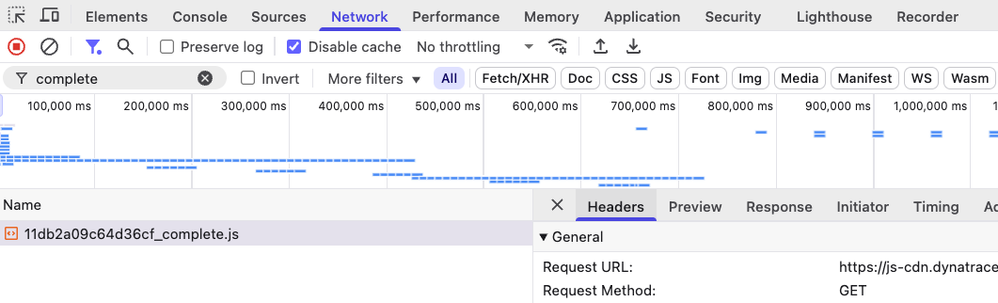

First, check if the JS injection is working correctly by opening the Chrome developer tools on your application and searching for a request ending in _complete.js (the beginning of the filename will vary).
  1. If the request is failing, please check if the request URL should start with https://js-cdn.dynatrace.com
  2. If the request URL looks correct but you're still getting an error, please check your firewall rules and that your application can access the public internet
  3. If everything above is correct, please open a case with a HAR file attached containing the replicated issue.

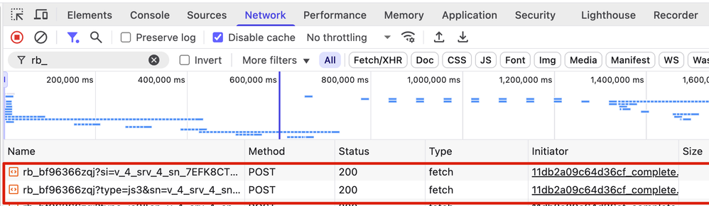

  1. If the JS request is successful, next,  check the beacon request to see if the data is returning to Dynatrace.
  2. To view the beacon data, open up the Chrome development tools and search for rb_ OR bf_
  3. Check if the beacon has a status other than 200.
Example of a successful request beacon
  1. If your beacon returns with a HTTP status code such as 503 or 404, this is a configuration issue, and continue to proceed to the Resolution below.

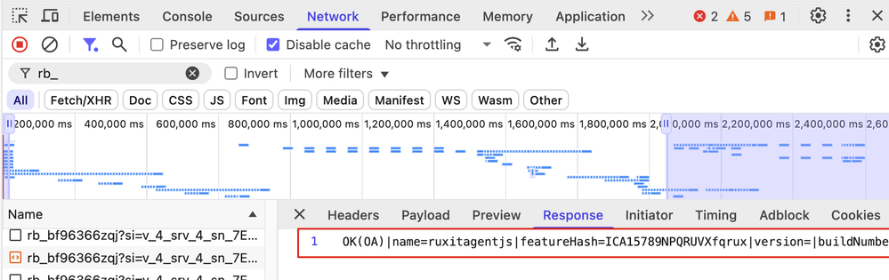

  2. If the beacon's response does not start with OK, please check your firewall rules or how your application may handle URL routing.
An example of a successful request beacon payload
